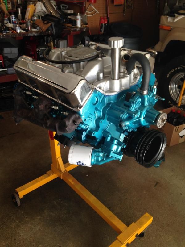

She is now moving under the power of a freshly rebuilt 360.  I've only broken in the cam and taken it for a few quick rides around town.  I'll post up more info as I get everything squared away.
It feels good to have a running Jeep again...  I miss NEJ
Ready to install (2nd time...)
Dropping her in.  Twisty - do you remember what your hoist even looks like?
« Last Edit: September 17, 2014, 06:19:01 AM by cj7fan »
