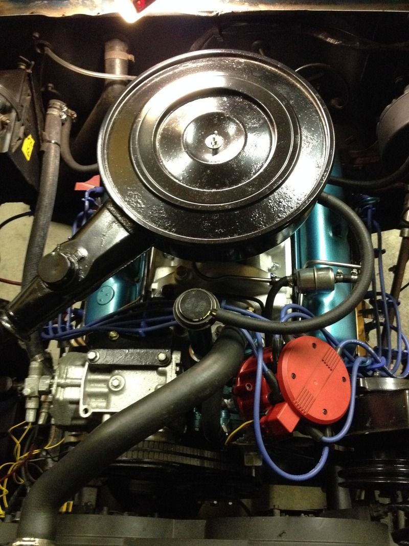

I have the electric fan wired and running. I've been pushing the rig in and out of the shop to get other vehicles on the lift and it's getting old so I focused on getting the engine up and running. I made sure all the engine bay wiring was correct and it was ready to fire up for the first time.
After a short cranking period it fired up, it felt good hearing the engine after all this time, I would say the second best thing to happen with a build. I checked oil pressure, good, checked vacuum not so good. It was to be expected because I needed to set engine timing and adjust the rebuilt carb. The engine was running rough at 14” vacuum. I tried to set the timing but couldn't steady the engine long enough so I set the timing with my vacuum gauge. I moved onto the carb adjustment. Again using the vacuum gauge I tried to adjust the carb but it wasn't working, no setting would help the engine vacuum. I also noticed an oil leak from the oil pan gasket (my fault). I stopped to think things through and decided to check for possible vac leaks. I thoroughly check all possible leaking points with propane and found none. At this point I couldn't time the engine properly or adjust the carb and I had an oil leak. I decided to step away for awhile to do some other projects around the house and yard.
After a month away I came back fresh, I dropped the oil pan and installed a new gasket, this time with better results. Then I just stood there and stared at the engine for awhile thinking things through, I knew I had to start from step one TDC. I did, and found the problem......distributor was off one tooth.
I now could set the timing and adjust the carb. The engine is running great at 20” vac. Last weekend I drove it down the road a short ways. I still have a ways to go but it's progress.
