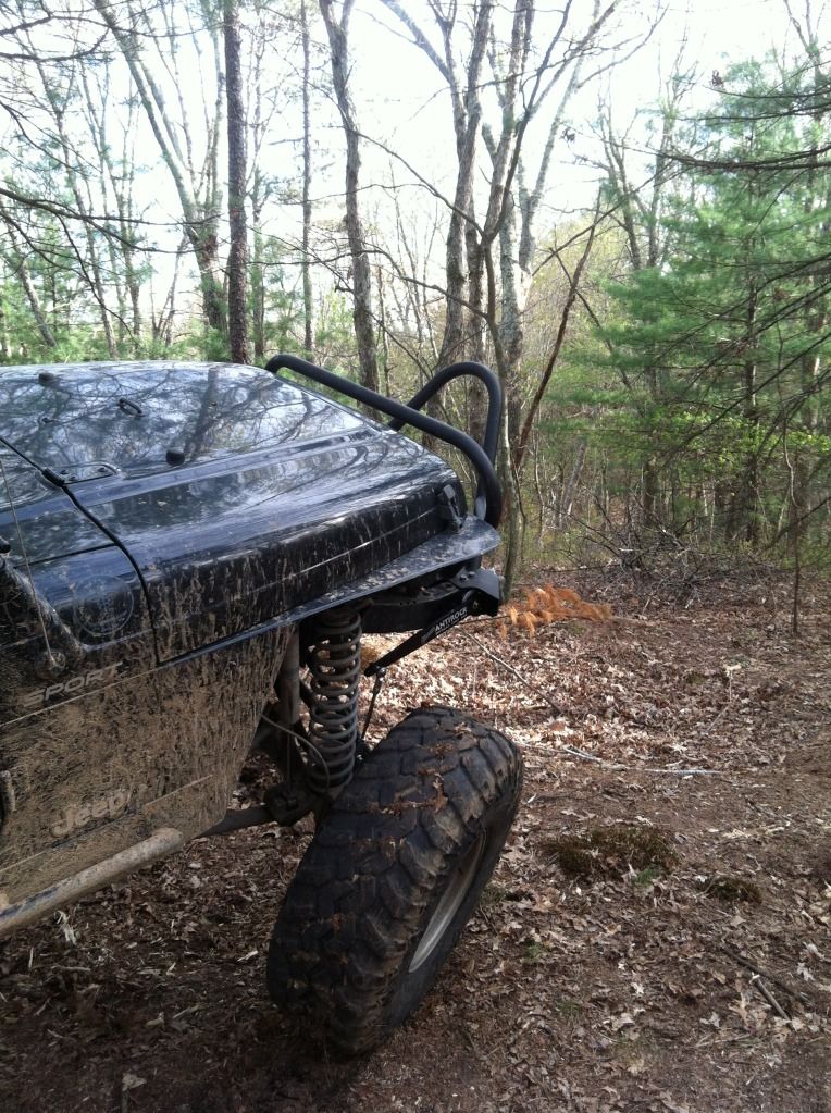

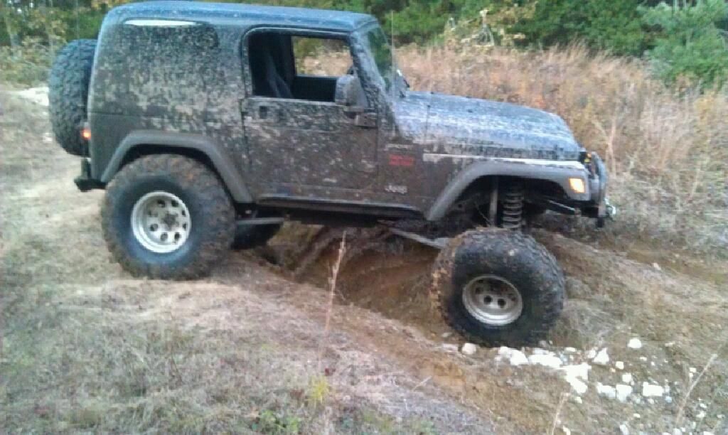

so I guess I've made enough mods so far to deserve a build thread now.  and maybe having a tread going will keep me motivated to keep working on this piece.  bought it last year with just over 50k on the clock and a good starting point for what I want.
05 TJ sport w/auto
d44 front w/4.88's, arb and chromo's
d44 rear w/4.88's, arb
5.5" RE long arm
some sort of cross-over steering w/heim rod ends
37" irok's on mickey Thompson wheels
psc rocker knockers
Couldn't have been happier with the decision and the purchase.  wished it was a stick but o well.  it came with hard top and soft top.  they also threw in a safari top and duster.  They also gave me a set of uninstalled crusher corners w/3" flares...I removed the flares and bolted them on when I did the front fenders.
first off went the flares and most of the front fenders after a run-in with a tree at the sawmill.
then I needed a stubby front bumper so a call to Gen-right fixed that.  While everything was apart I decided to throw an anti-rock in as well.
For some reason the previous owner swapped in the d44 rear axle from an earlier tj, because I ran my vin and found out it came from the factory with a d44 and disc brakes but I had drums....odd but o well.  I bought the tera-flex disc brake conversion and some superior chromo shafts for it.

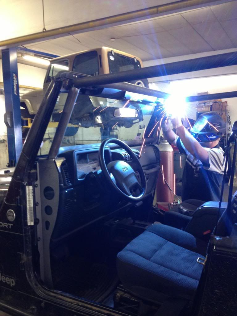

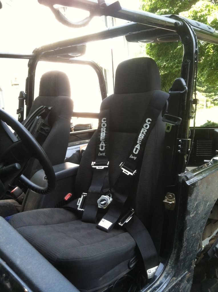

I then decided I needed some protection, so I got a psc trail cage, bolt on harness bar and a set of corbuea 5 points.

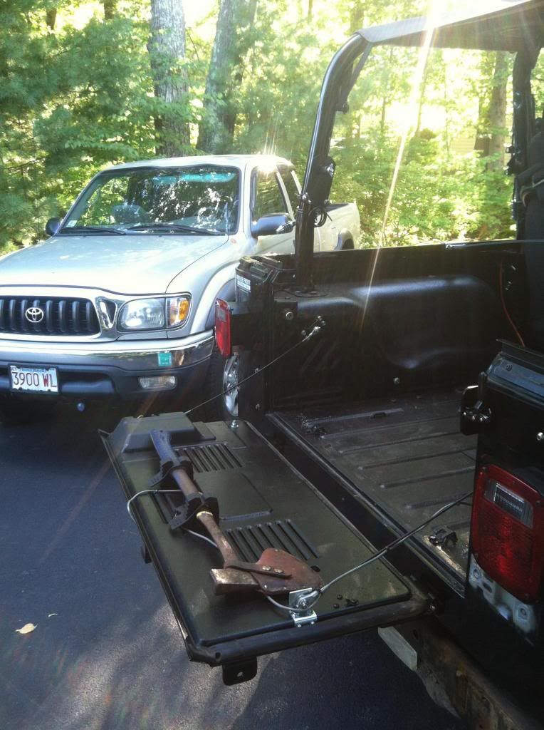

After the bumper I decided to convert my tailgate to a CJ style drop down with a swag conversion kit.  good kit, crapy directions

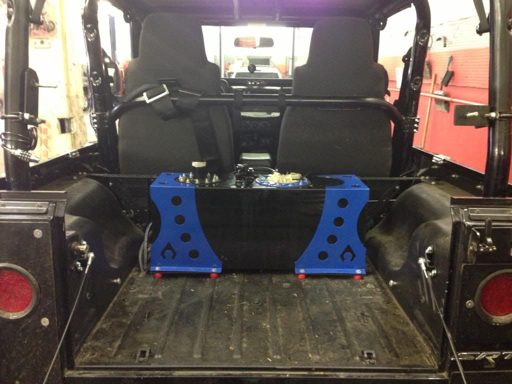

My plan is at some point in the future to stretch the wheel base back a few inches and 1-ton the jeep, so I need to start making room, so the gas tank had to go.

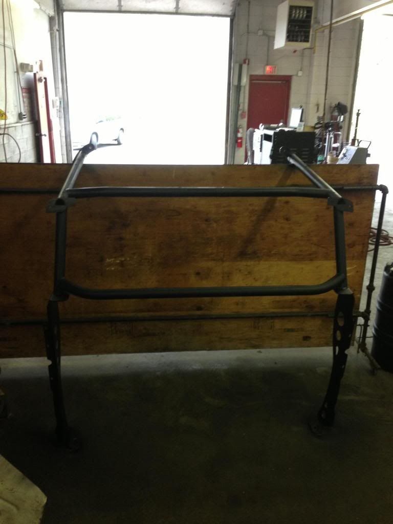

Good stuff. Does that style of roll bar offer enough protection to the a pillar? I am thinking of something similar but unsure about how the sheet steel holds up compared to a traditional bar to the floor.

A single tube from the floor to the top of the a-pillar will be stronger but you have to drill thru the dash or give up a good amount of foot space.  I know psc had issues with the original design which is why there is no longer a logo in the legs.  I ran there old style in the first jeep with no issue, which is why I went that route again.  But with that said I do plan on adding a lot to it.  I want to add vertical bars from dash to upper cross-bar and some door and seat supports when I get new seats.
