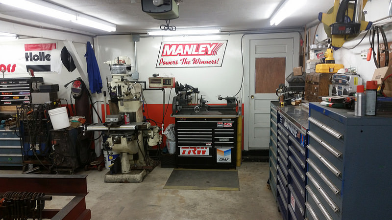

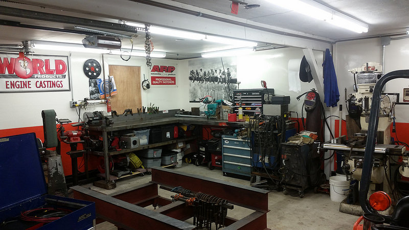

« Reply #18 on: March 20, 2015, 05:29:58 PM »

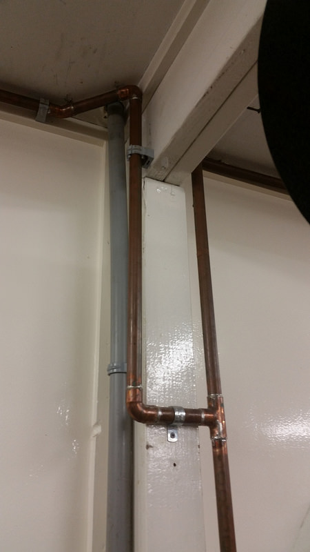

wanted to post some updated pictures now that i'm all finished up. only thing left to do is heat but thats going to hold of till funds are there, till then i bought a $100 5600Watt electric heater that takes the edge off. its not cheap to run but worth it for the amount of time im out there.

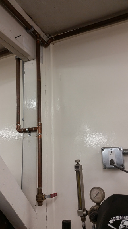

all copper piping for the air. mounted overhead.

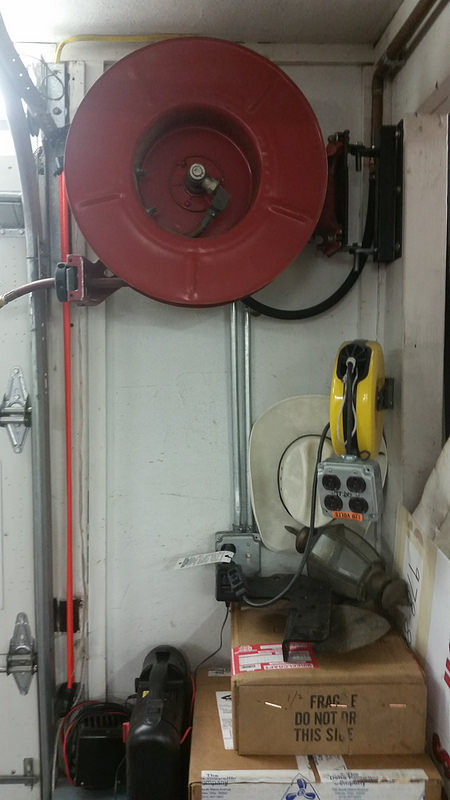

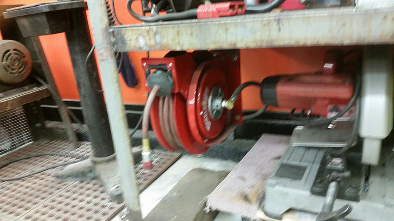

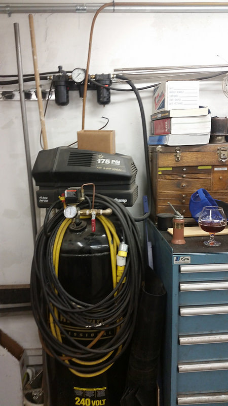

hose reel under the bench and mounted on a swivel mount on the wall.

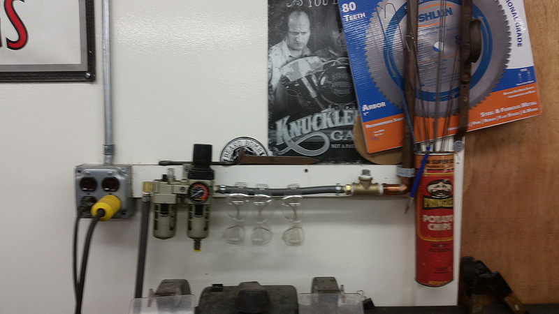

regulators and oilers built inline, I keep the oiler for the big hose reel empty in case i want to use it to spray paint.

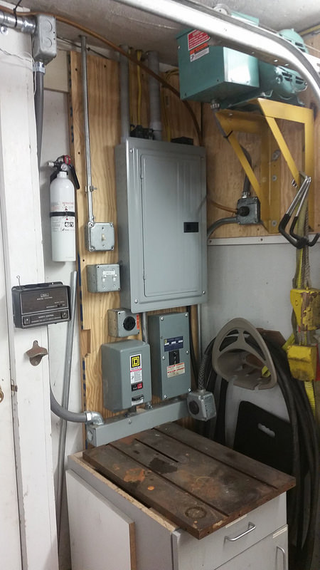

And heres where all the power is managed, 3 phase generator mounted up high behind the garage door track to run the bridgeport.
100Amp 20 circuit panel. Also have a 50Amp 75' 220V extension cord so i can drag the MIG out in the yard if needed.
Compressor is wired to a 15A 220 plug for now because it will eventually live outside in its own little home, nice and quiet like. most of the power was run in surface mounted conduit.

« Reply #19 on: March 20, 2015, 05:55:54 PM »
Looks fantastic!
Re: garage move
« Reply #20 on: March 21, 2015, 07:22:41 AM »
Excellent!
Re: garage move
« Reply #21 on: March 21, 2015, 09:10:11 AM »
very very nice!

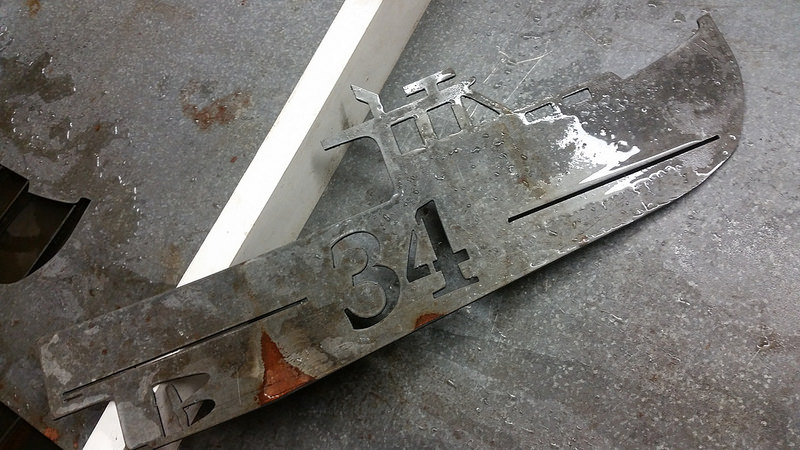

A little action in the shop today.
Cut a new number plate for my house.
https://www.flickr.com/photos/84661798@N03/16307260234/

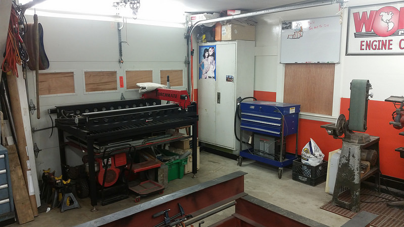

« Reply #23 on: March 26, 2015, 06:31:48 AM »
You finially got the tourchmate up and running.
Re: garage move
« Reply #24 on: March 26, 2015, 07:57:11 AM »
yes, the garage project was priority, fired off the plasma a couple weeks ago then had a few hardware issues i've been dealing with, put a new hard drive in the driver laptop and shes back up and running yesterday.
