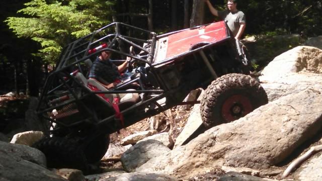

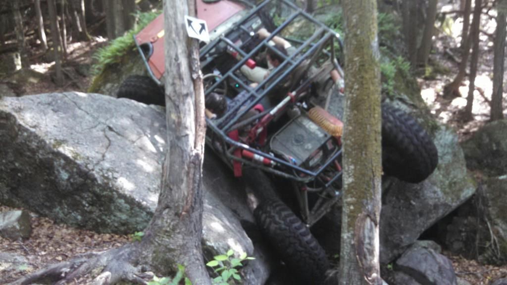

And some wheeling pics.  Thanks to Jerry for sending them to me.

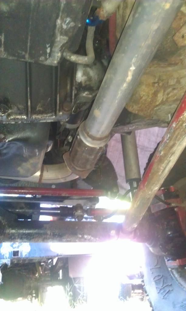

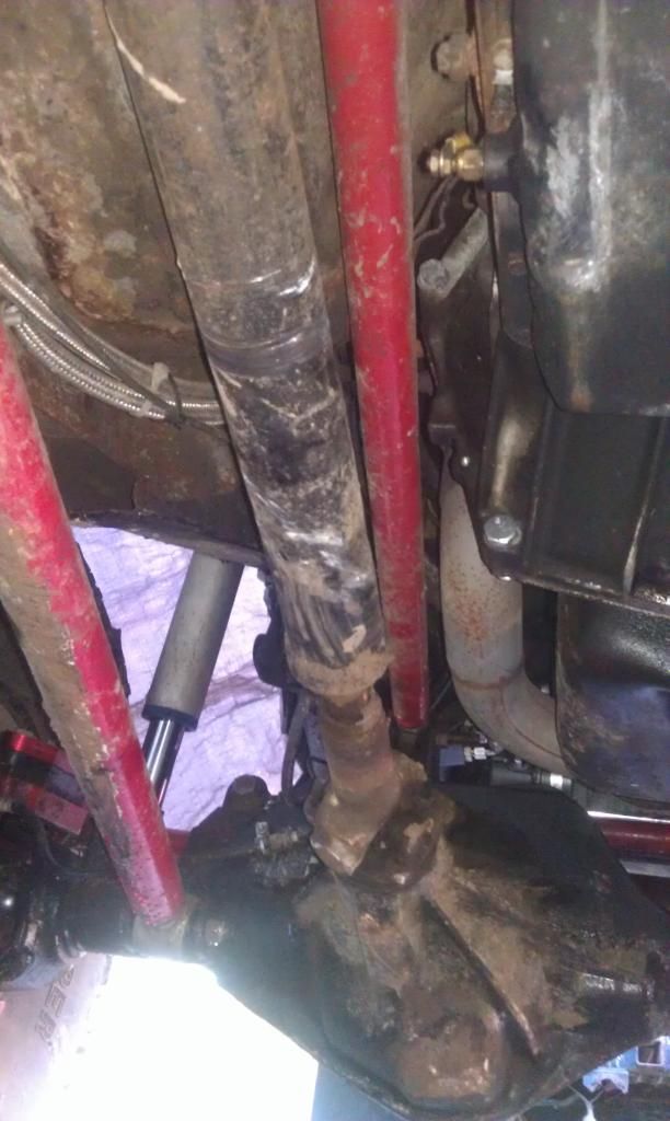

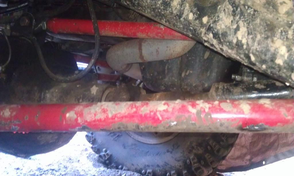

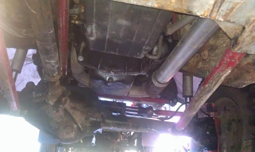

Post a couple pictures of the underside of the mj.  I'm curious what there is to build against.
Re: Thriller MJ
« Reply #665 on: September 14, 2014, 09:42:53 AM »

Placed an order for the teraflex skid.  Hope I can get it installed before rocktoberfest.

Picked the skidplate up from Elais4x4 today.  Hope to get it installed tomorrow or Friday. 8)

I have no idea what your are insinuating.  My rig is totally and completely 100% bolt on mail order merchandise.

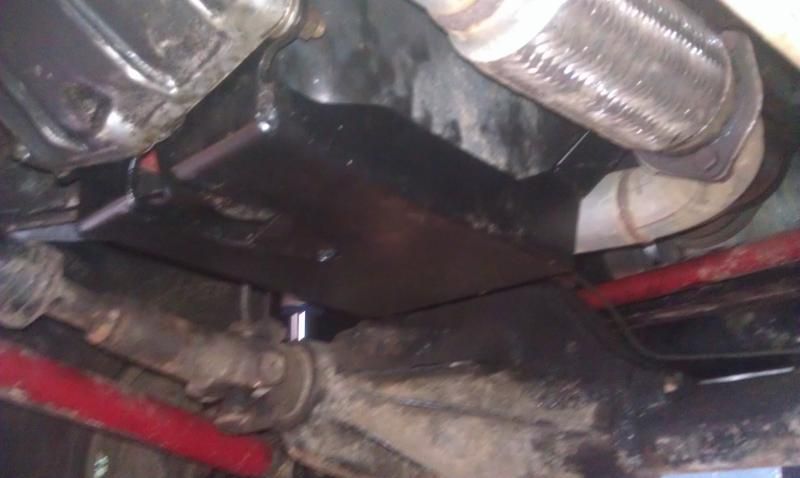

The skid is on and the oil is changed for the first time since Fall 2011  :nuts:.  The plastic covering on the knock sensor fell apart and I had to piece it back together using RTV and a hose clamp.  I should get a new one, but they aren't exactly common and are priced around $55.  I'm hoping that I might find a used one around somewhere.  Wishing I still had that red XJ I scrapped a few years ago.  ::)

Ok, snapped a quick pic.  Please excuse the quality.  I was ducking under a tarp in the monsoon like rain that had just started.  The skid cleared the exhaust just fine.  All the holes lined up great too.
And my connection at Advance Auto ordered a knock sensor for me.  It will be in tomorrow afternoon.
« Last Edit: October 16, 2014, 11:28:20 AM by Twisty »
