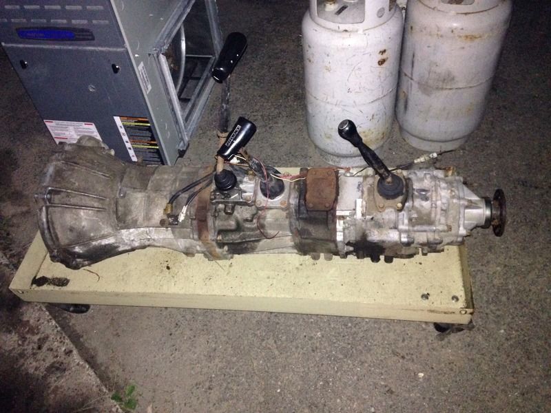

« Reply #7 on: September 16, 2015, 08:29:02 AM »
Updated the first post
Picked up some major toyota bling
R151f with a 23 spline doubler set up.  4.7 gears in the rear case and a marlin 30 spline output kit on the rear output
I want to put a 30spline front output on it eventually but marlin has been sold out for months
