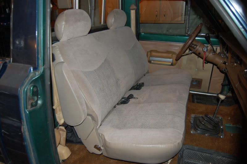

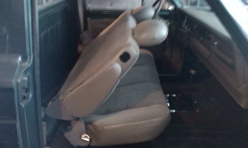

The biggest thing that I recently finished that was a relif was the installation of a bench seat.  The off-road bucket seats that were in there were ok when you were in them, but a realpain to get in and out and I wanted a bench.  It turns out luck was on my side and Jeff down a Crown (Thanks Jeff!!!) had an extra bench seat that he was willing to part with.
I had to cut down the stock frame and weld on my own mounting brackets but the fit is perfect.  It went in and out a number of times to make sure I had the height just right.  It is now all bolted down and even folds forward so I can store some stuff behind it.

« Reply #18 on: December 26, 2009, 10:15:35 AM »
I like that Kent.  Buckets have there place but a Bench like that in a J10 is where it's at.  Looks great and versitile.  Great that you post what you do.  Not many Jeep builds like yours on here.

Fabric color works well with the interior. Are the center seat belts anchored to the bench or floor?

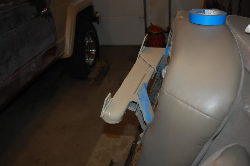

Posi - All the belts are bolted to the cab in their factory locations.  The mounts are just for the seat itself and I used 3/16" plate which was thicker than the stock so I sould be more than good there.  There is also a center set.
Here is an updated shot with the belts showing:
Here is a shot of painting the mounts/tabs:

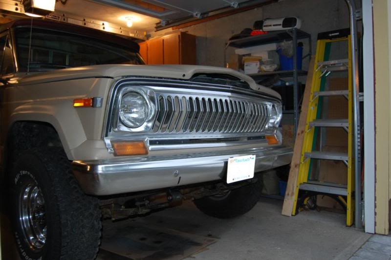

I also ditched the custom bumper that came with the truck for a stock unit.  It actually was a pretty decent bumper and had nice 1/2" plate that ran down the frame and made D-Rings.  It worked well for jacking the front end with the Hi-Lift.  I think I have a buyer for it so off it goes.
Thanks to Bob for grabbing the Alum bumper (NEJ Express from RI) and after a quick buff with a powerball here it is.
Guess you can tell what color I'm going with the truck for now....... ::)

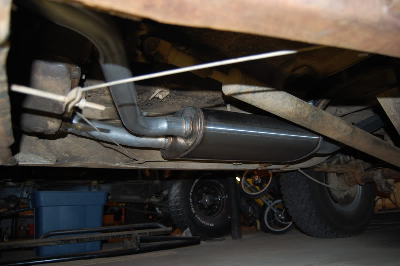

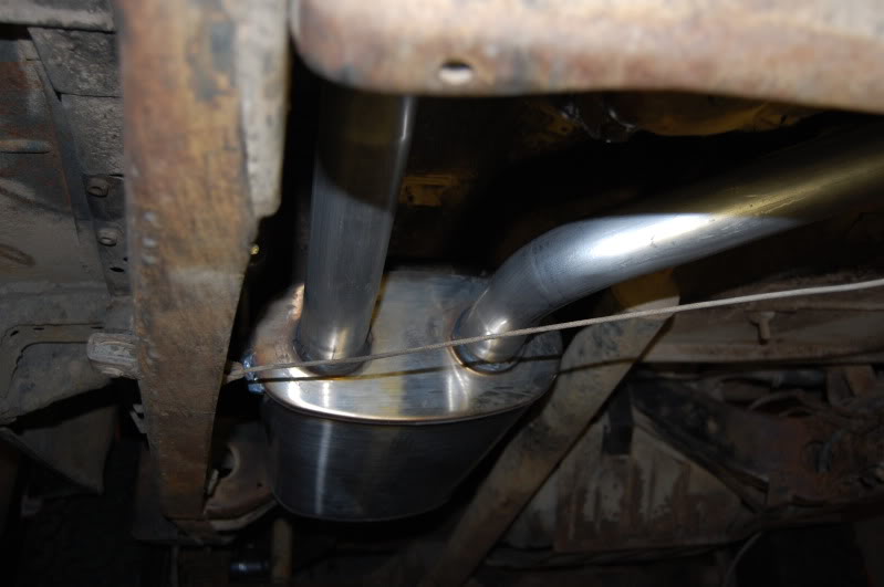

A little project update as I knock off some items on the "to do" list.

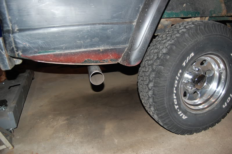

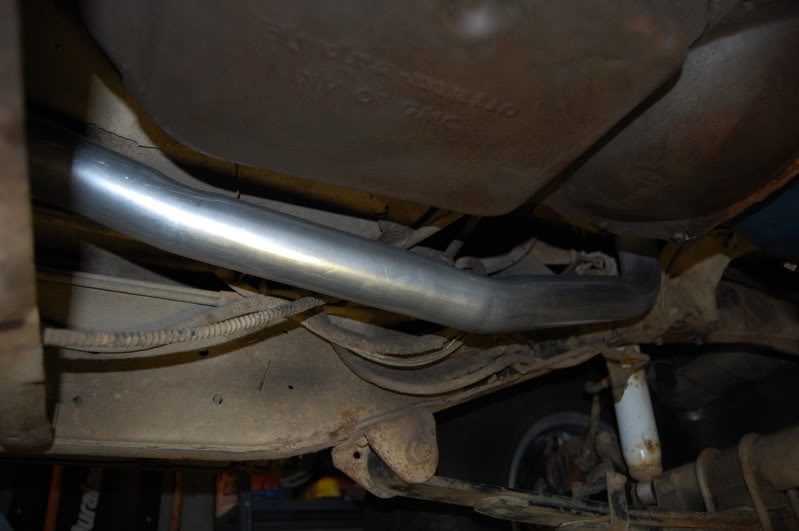

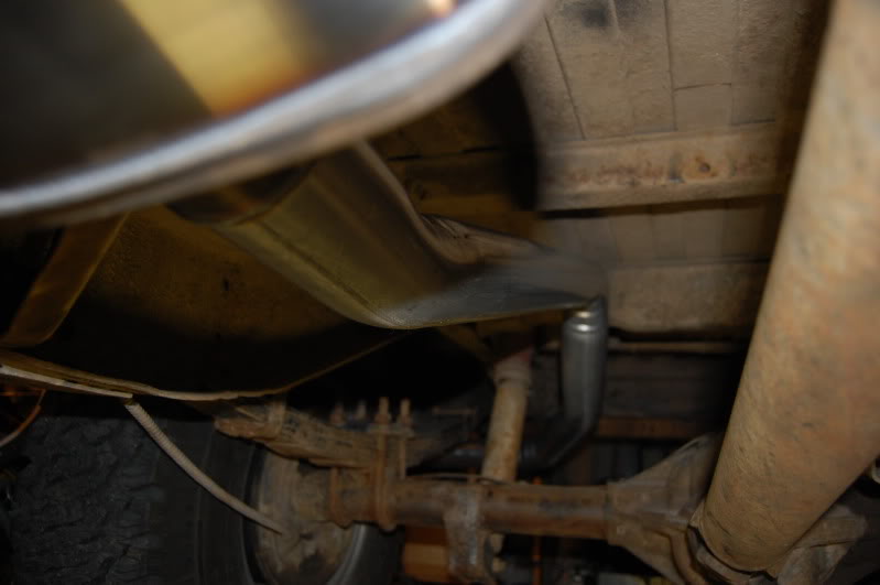

I got the exhaust done last weekend.  I ditched the thin rusted headers for a set of the stock manifolds that flow pretty well.  I coated those and bolted them on.  Then it went up to see Jay... this guy is awesome!
System: 2.5" run from each of the stock manifolds to a Magnaflow 22" stainless muffler with a 3" piple that dumps in the stock location.  It is nice and low at idle and just rumbles a bit under light load.  When you really lean on it.... she speaks up :burnout:
Pics:

« Reply #24 on: February 01, 2010, 12:38:31 PM »
glad someone is making progress!!
jealous on your bumper! Wish I had a nice stocker..mine had the ends cut off so I just painted it black and added a factory brushguard from a Honcho.
Shoot me a pm on where you had the exhaust done & how much...I was going to go local when I get to that point but that looks well done.

I used AAA and thanks again for offering to help.  I didn't want to drive up there with just the manifolds.... :woot:
Jetboat - Under Construction
Re: My Next Project
« Reply #29 on: February 01, 2010, 03:16:42 PM »
Why manifolds and not headers?  wondering
