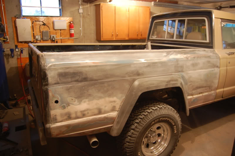

Well I have been traveling a ton for my new job so progress has been slow.  I am still working on doing some baisc body work/repairs and getting the J10 one color.  In the last few weeks I got a passenger door from a Wagoneer and used it on the J10.  I had to strip it of everything (woodgrain, power mirror, power window, fly window, handle, lock, etc) get it painted and then install all the manual components from the original door.  I was able to get new handle and lock seals plus window wipes from BJs for really cheap.
Here are two quick photos of my progress... getting there.  She runs like a top and the new exhaust sounds awesome so dispite the multi color paint job she is out just about every weekend.
There is also an added bonus pulling up to all yuppies in a Range Rovers and BMW trucks with a rig loooking like this.....if there was any question, they let me go first. ;D

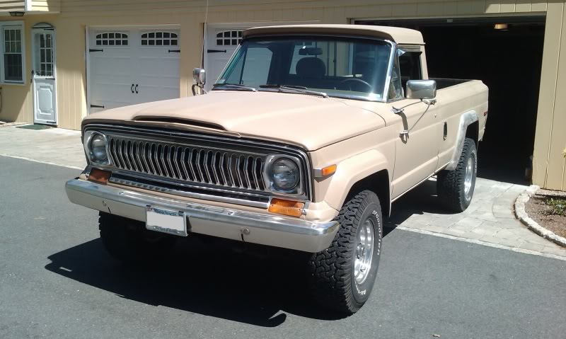

Ok, I have been slacking on updates but I actually haven't been able to get much done lately... where is the summer going?
I finally have it just about all one color:
I also added a factory air dam from a J10 that was in perfect shape.  Not a bad $10 and I like the way it looks with the stock alum bumper:
