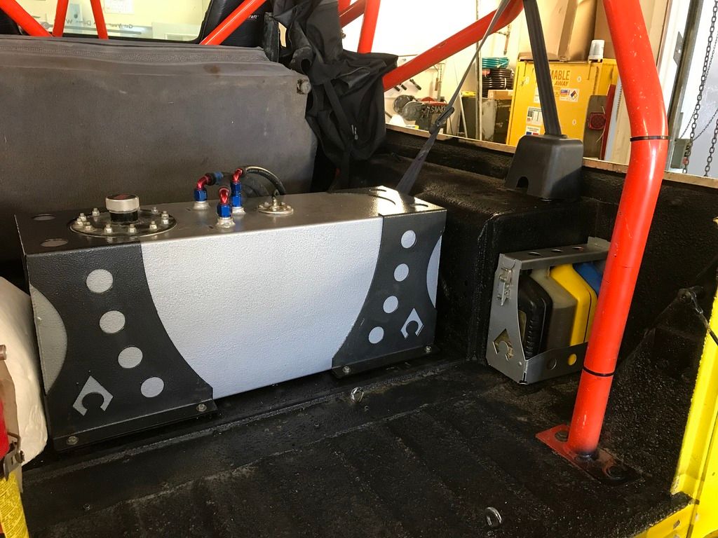

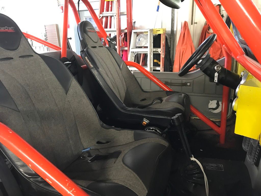

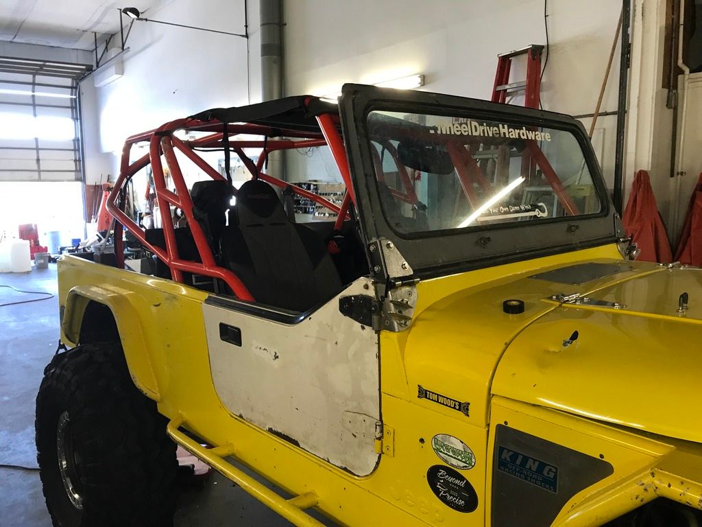

Got my seats in and door liners cut to fit. I'm thinking of just skinning the door int with aluminum.
Windshield on with new hinges
Quart crate and fuel cell mounted
Even messed around with the welder today
Little bit of body filler and it'll be fine...
Gotta get it back to the shop to address the brakes and belly pan before F&F in Oct
What's everybody using for brake set ups on their 1 ton rigs?
Current set up is a corvette MC on a cj booster. Brakes are ok, but if it ever sees the road I would like them to have better feel. My old rig had a YJ booster and a dodge 2500 MC. It felt a bit better, but still not great...
Ideas?

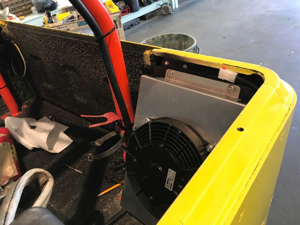

Trans cooler mounted
Having my junk at work has been really helpful. I've been able to knock out a bunch of small projects during lunchtime...
Time to make room for the boats though...

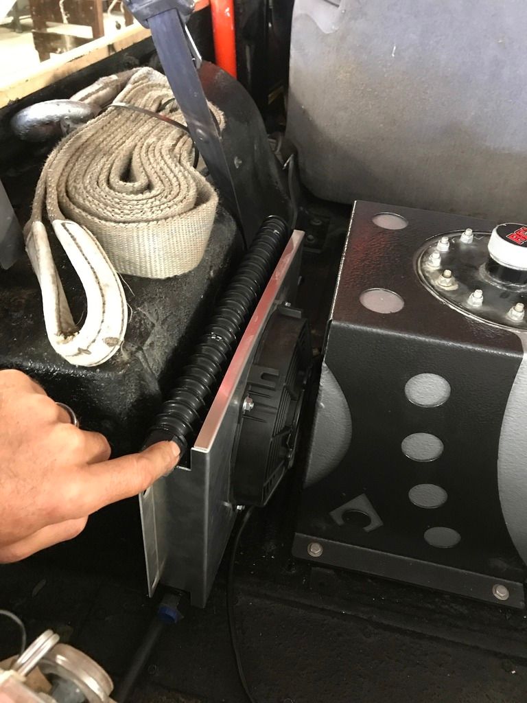

Do these plate coolers need to be mounted a certain way? My old rig had the fittings on the side, In thru the top fitting Out thru the bottom.
Currently I have it with the fittings on the bottom. If the fittings need to be on the side the cooler will have to get mounted next to the fuel cell (less air flow)
SI VIS PACEM PARA BELLUM
  • Posts: 10671
Re: My 8
« Reply #56 on: September 09, 2017, 12:03:36 AM »
Cooler mounting is critical!  You never want to mount the cooler so both fittings are pointing down.  Its easy for air to get trapped in the top.  Either mount the cooler so the fittings are up, or sideways.  If sideways, always have the supply line enter from the bottom.  That way all the air will be pushed up and through the system.
Offline Bosox
  • Posts: 248
Re: My 8
« Reply #57 on: September 09, 2017, 07:31:39 AM »
Thanks Tim, I'll flip the cooler
Offline Bosox
  • Posts: 248
Re: My 8
« Reply #58 on: September 09, 2017, 08:49:12 AM »
Final resting place...
Fittings on top, kicked out the bottom to take advantage of a nice hole in the floor.
