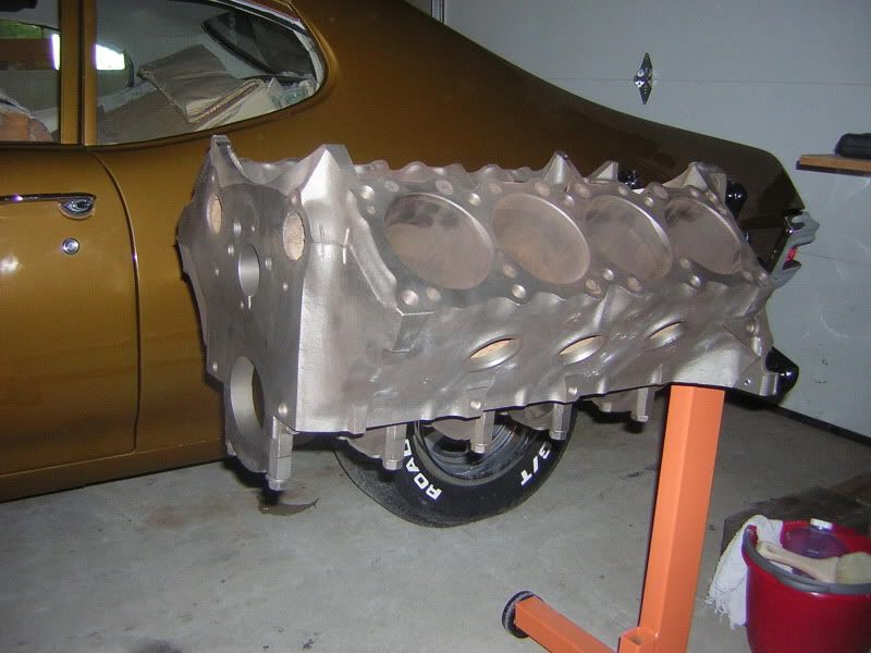

here it is;

Quote from: Krome on August 25, 2009, 02:23:22 PM
wow cool. how much was that thing!
It is a 69 428ci hot tanked and magna-fluxed, $400 .

A local machine shop will do the machine work, I (and Lynn, since its her car
)will do the assembly.

Is it a 2 bolt or 4 bolt motor?

alot of the pontiacs were drilled and tapped for 4.(this one has the holes & is tapped already) It came with 2 bolt caps, but I will be adding the 4 bolt caps.

Is it standard bore?
What compression will you be running?

It will be .030" over with a longer stroke crank (4.250"). Depending on the heads we choose, I'm looking for about 11:1. this is the kit I am leaning towards;

Thats allot of compression, dont think regular gas will do. Might have to go with race fuel, what do you think?
