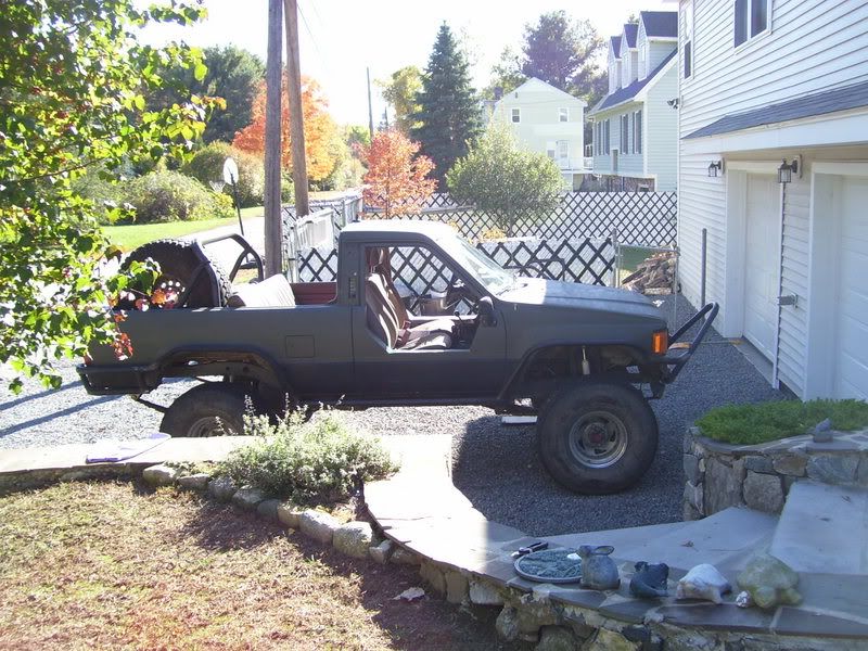

i told tim last night over at ians that i would post my build over here
this is how i bought it in febuary of 07.  it was a 1986 4runner with 227k on it 22re w56 ifs front with a toy 8in in the rear
needed an fair amount of rust repair but the motor ran great

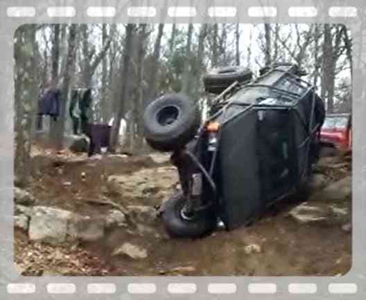

flopped it at mabell

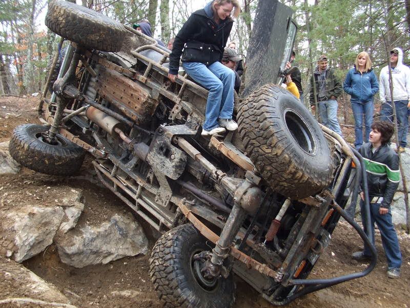

rolling it back
and the damage
just call me stubby

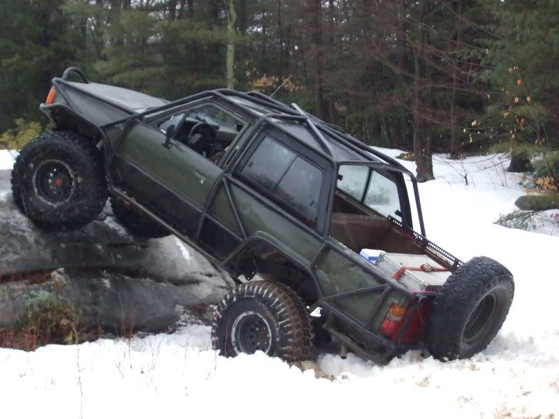

almost done :great:
n
36x12.5x15 tsl sx on and wheeled for a while

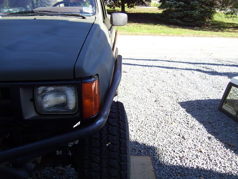

started my front bumper tonight too
im going cut the grill and some of the rad support to fit the winch in
put a third coat of paint on everything,  did my front brakes and started the winch mount
and just incase any one didnt notice my new nose and many other parts came off jays old 4runner so it can live on in mine a little
