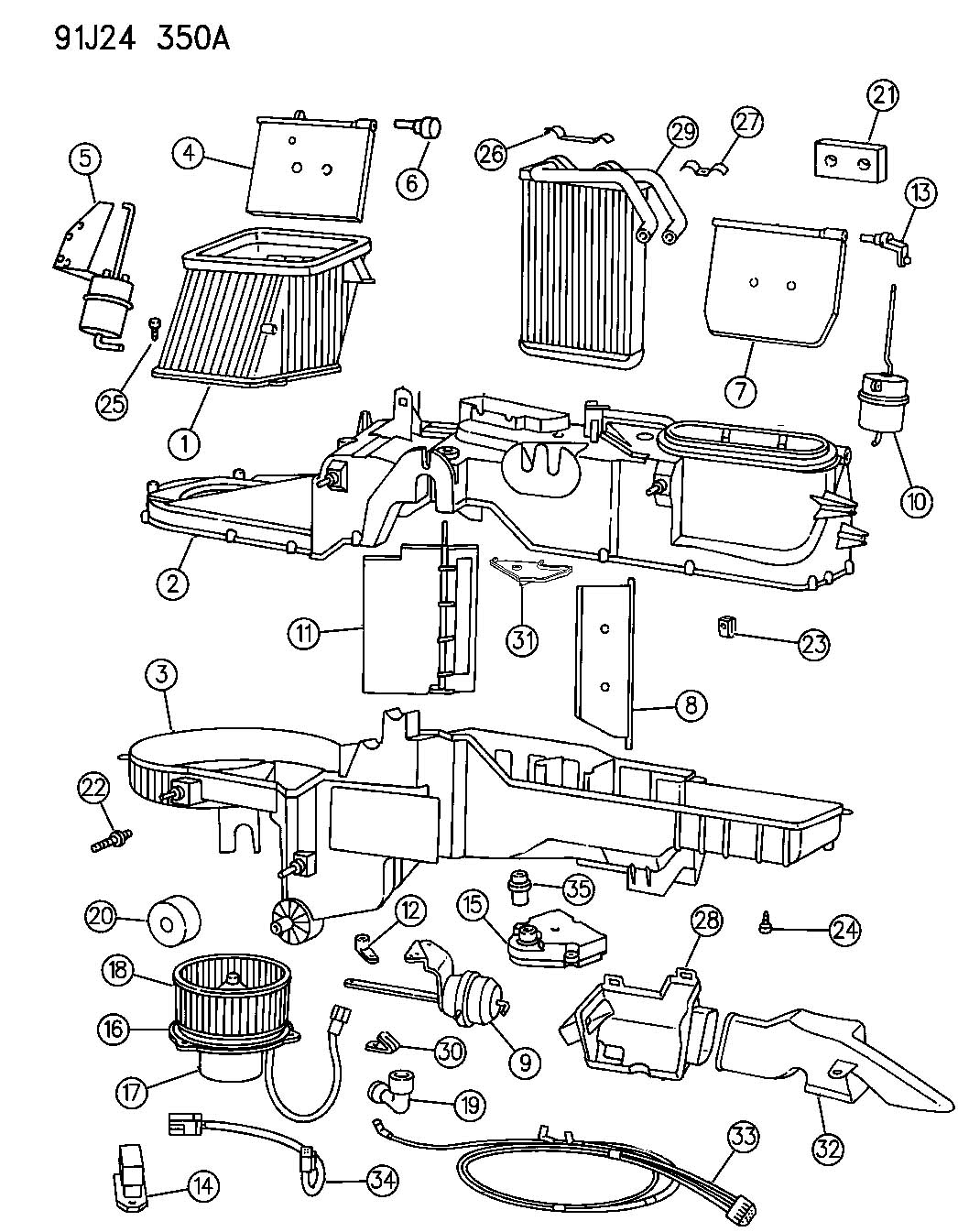

First, check the connecter plug, sometimes they burn out. Second, check the motor followed by the resister, and finally the switch.
The wire coming from the motor should lead to the resister just follow it. Should be mounted to the heater box by 2 screws.
http://www.factorychryslerparts.com/images/parts/Chrysler/fullsize/0000098A.jpg
Edit: #14 is the resister.
