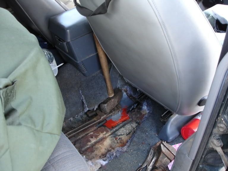

really, I remember your carpet catching on fire because the rot hole was above the muffler and then it got ripped out after a fire extinguisher was unloaded on it. IIRC the sheet metal came from some hillbilly town in pennsil-tucky and was half ass fixed in a home depot parking lot.

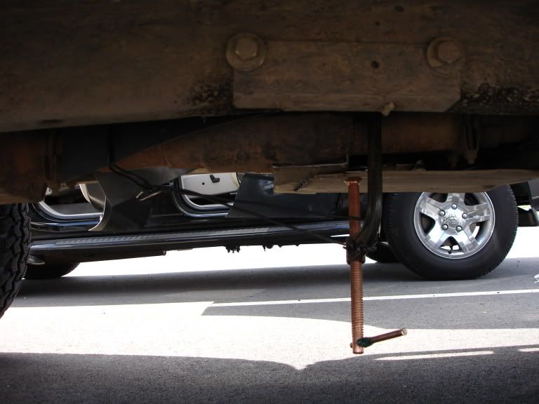

lol that was the first "trail" fix from smashing my muffler/cat up on the floor which overheated the sh!t outta it, that fix was hilarious. but after i got him i fixed it permanently through the above mentioned procedure. now i dont have to listen to the wife complain of the fumes from burning carpet, but she does burn her foot every now and then when she is wearing flip flops
i think it was the hammer/pipe wrench combo that did the trick
