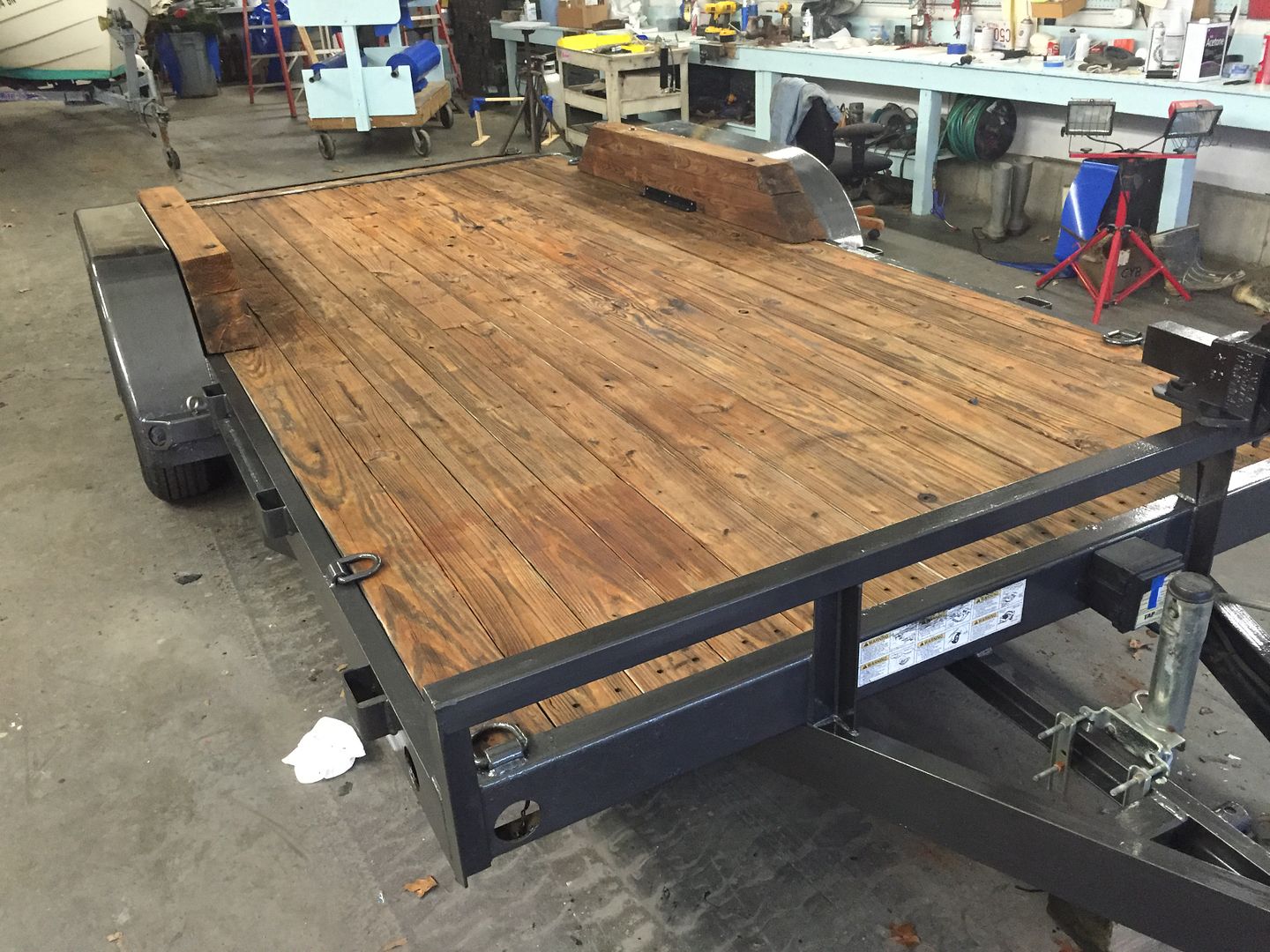

« Reply #18 on: November 22, 2015, 05:52:14 PM »
More trailer maintenance today. Adjusted the brakes and found out why I've been having trouble with them. All the connections for the wires coming out of the back of the brake are made with scotchlock connectors. All connections had green corrosion when I opened them up. Seems like a silly thing to use for exposed connections (I don't even like them on interior stuff).
Anybody seen these used on trailers from the factory?
SI VIS PACEM PARA BELLUM

« Reply #19 on: November 23, 2015, 11:00:29 AM »
Painted it yesterday too
Rustoleum hammered black brushed on. Same color as the chassis on the Juggy. Swapping in leds next...

« Reply #20 on: November 23, 2015, 12:08:09 PM »
looks great.  looks like a brand new trailer!
