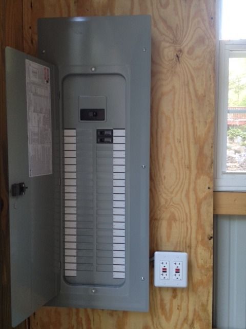

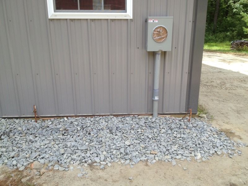

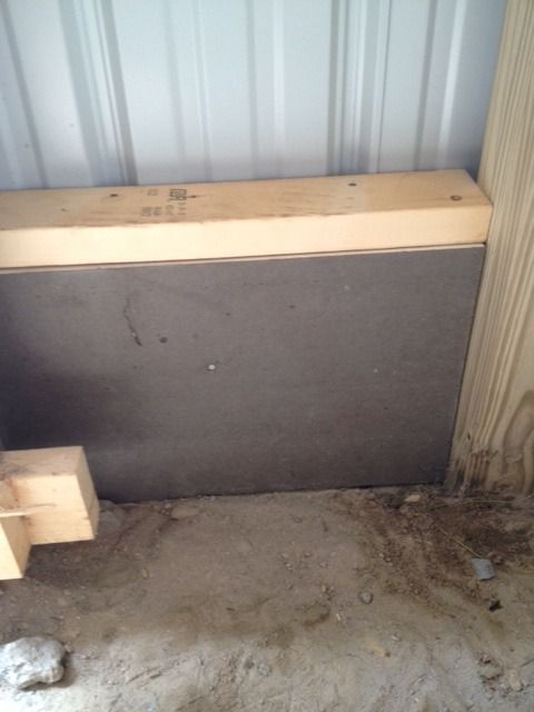

spose I should update this; with the help of Brooksy, got the 250' of underground wire in and passed the inspection to get service to the barn. also started the 1' of 2" closed cell faomboard around the perimeter. next is the radiant then we can finally pour the 5" 5000psi concrete.
