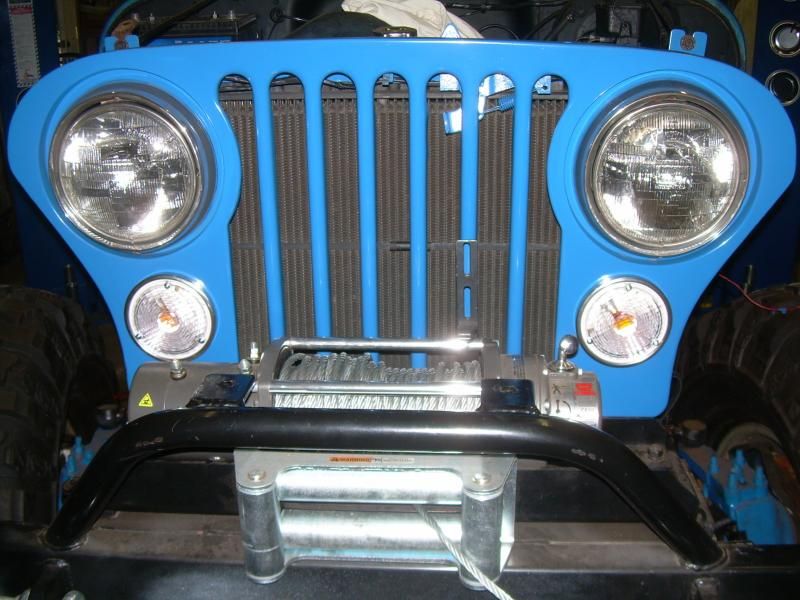

Thanks guys,
After installing the grill I noticed the hood didn't align with the tub correctly (front of hood was higher) so I shaved off 1/4” from the rubber grill mount and that leveled the hood out nicely.
When I purchased the paint to do my Jeep I chose valspar ford blue, but since then TSC stop selling valspar brand and went with majic. I'll need to color match for touch-up paint down the road so I thought it best to return the gallon I already purchased and go with majic. For the record you can still buy valspar paint at a number of retail stores, lowes being one however, I chose to give TSC my business. Majic paint is base out of Columbus Ohio. Yenkin-Majestic is the parent company and has been offering paint coatings since 1920.
I had to strip the recently painted valspar produced off my dash and repaint it using majic. I also painted, wired, and installed my grill.

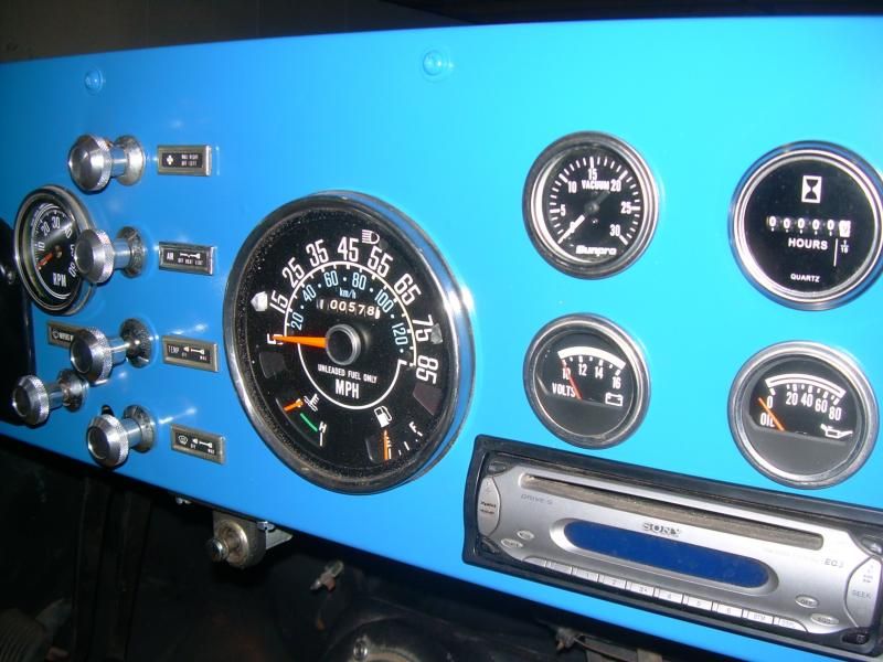

Thanks for the comments,
Finished the dash wiring and added a couple gauges. Thought an hour meter would be a good addition and far more useful then a speedometer when comes to maintenance and trail use. I also added a vacuum gauge the most bang for the buck on-board diagnostic tool. Besides the ability to diagnose the valves, valve springs, and valve guides or a leaky intake, head gasket, or choked muffler you can also set timing and tune your carb.
I added a marine grade toggle switch for on-board air and a 3000 psi Parker ball valve for a rear brake lock.

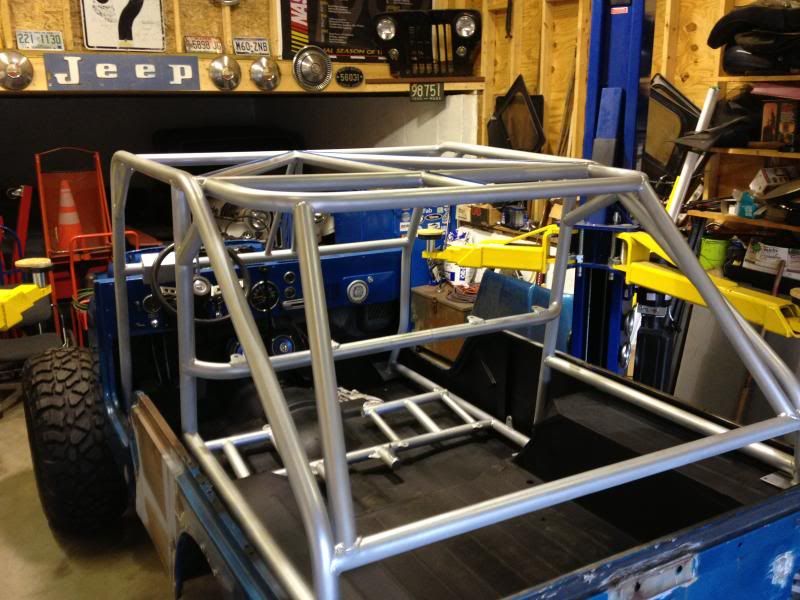

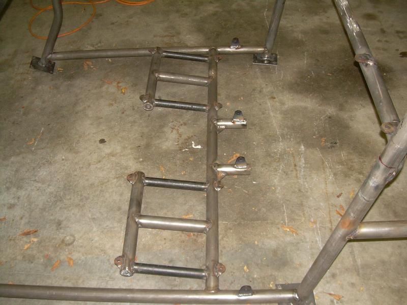

Thanks guys,
I added brackets to attach the cage seat harness. I used the lower brace between the A and B pillar to mount the outer lap belt at a 45* angle however, I needed to add some tube to mount the inner lap belt bracket to achieve the same 45* angle.
A before pic of the cage with builders Ian, John, and Tim (thanks again guys).
I added a few pieces to finish it off.
After several hours of prepping.
I still have 1 or 2 hours more of prepping the tight areas.
