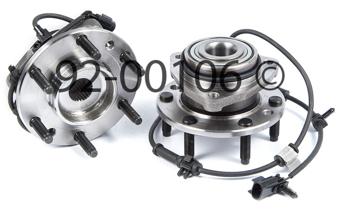

Go for it yourself Toochie. That part is correct but the picture is not. Looks more like this:

So it looks like it's an entire hub assembly not just the bearings within.
