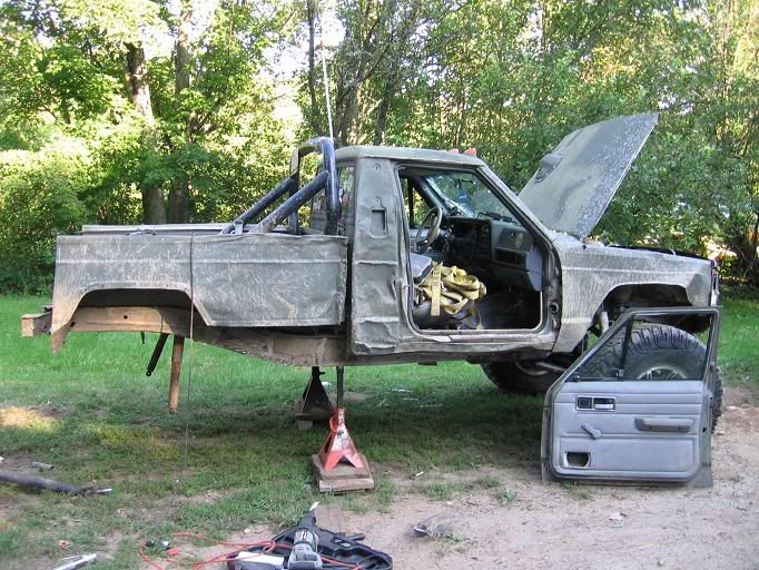

is that the new jeep comanche short bed version?  looks good, is that going to change your wheelbase as well?  think it will be ready by next weekend?

Ya, just rolled off the line.

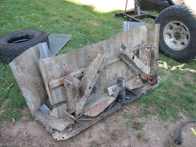

I'm going to bring the wheel base down to 109.5".  I just have to move all the mounts 1' closer to the cab.  Shouldn't be too hard.
Another reason for doing this is my rear bumper was not safe enough for a heavy pull.  I have backed into many trees and the metal was beginning to bend and tear.  I'll get a pic to show what I mean.
It should be ready for the FC.  I don't think this will be a hard undertaking.

are you reusing stock brackets or using new ones?  definetly sets it even further apart from everyother mj out there.
I'll be making some new ones out of 3/16".

you just moving the spring pearchs or are you 4-linking it. my guess is just the pearchs like you talking about but if i know you, you all ready got the joints and the link stuff, LOL just kidding.

Just moving the spring perches 1' forwards.  I'm going to weld the bumper to the rear frame, and probably mount the shackles to the bumper to make it as short as possible.
I need to get grinding wheels tomorrow so I can make decent progress.
I have to have this thing done of Thursday in order to get to the Fall Crawl on time!!!!

And on another note, the rear frame on the MJ is boxed 1/8" steel.  Much better than the 16 gauge that I thought it was.

I like the look Tim, certainly will be more functional for our trails in NE.
It's 8 1/2" longer then a CJ6.
