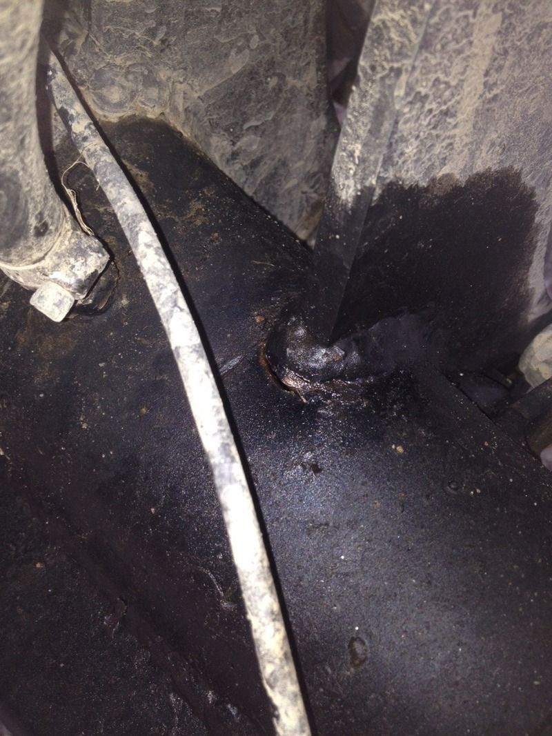

going to fast and getting air is a bad thing. Should I weld this with my little Hobart 140 (110) or have someone with a big unit do it?

Big machine, is the tube actually cracked or just the weld?

You could short term seal the leak with the 110 so as to not miss any wheeling

I would use the machine you have Bob, just make sure you prep the crack. Drill stop holes at each end, and grind a deep V into the crack.

Too add to what Chuck said, I would spray the piss out of it with brake cleaner.

Thanks guys, one of the OSJ guys is near me, Ricky with the yellow 1 ton tj , he can do it for me I think. I really want a deep penetration from a big init.

non chlorinated brake cleaner is cool. chlorinated cleaner is deadly when you when after.

all welded back together
