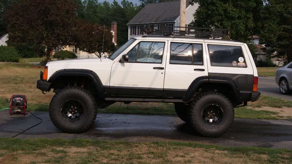

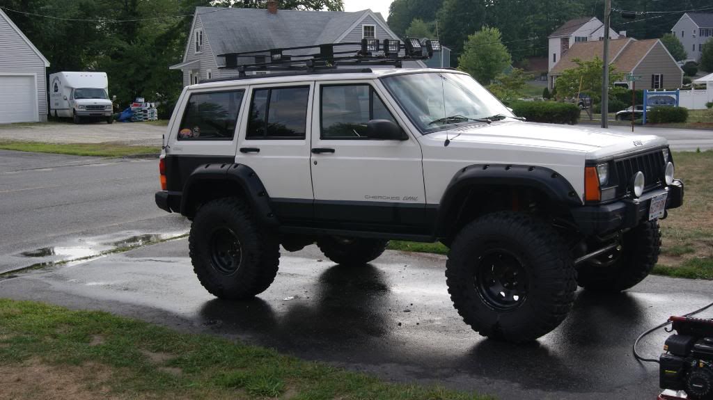

I can't think of a build name for this... I will try and document any progress to this already decently build rig.
Vehicle - 1996 Jeep Cherokee classic 4 door
Color - White
Trans – AW4 (automatic)
Motor – 4.0L inline six
Driveline – 4WD (NP231)
KNOWN ISSUES - upon purchase:
•   Needs passenger tail light Fixed 8/12/10
•   Hood release pull is broken Fixed 8/12/10
•   Slow bead leak in passenger front tire Fixed prior to purchase I believe - no leaks
•   Headlight bezel is broken, marker light falls out
•   Failed inspection as it would not connect with the inspection station. Power lead for the OBD2 port and a new ECU has been installed.Inspected 8/16/10 - passed
•   Bad ball joints Fixed 9/10
•   Bad TRE  Fixed 9/10
•   I smell a possible gas leak, but never see any drips.
•   Need a CB antenna - broken Fixed 8/12/10
•   front brakesFixed 8/15/10
•   E-brake cables for the 8.8Fixed 8/15/10
TIRES:
•   35x12.5x15 Maxxis Big Horns and outlaw wheels
•   35” spare mounted on outlaw wheel
AXLES:
•   Dana 30 Aussie locker with 4.88 gears and 297 axle shafts

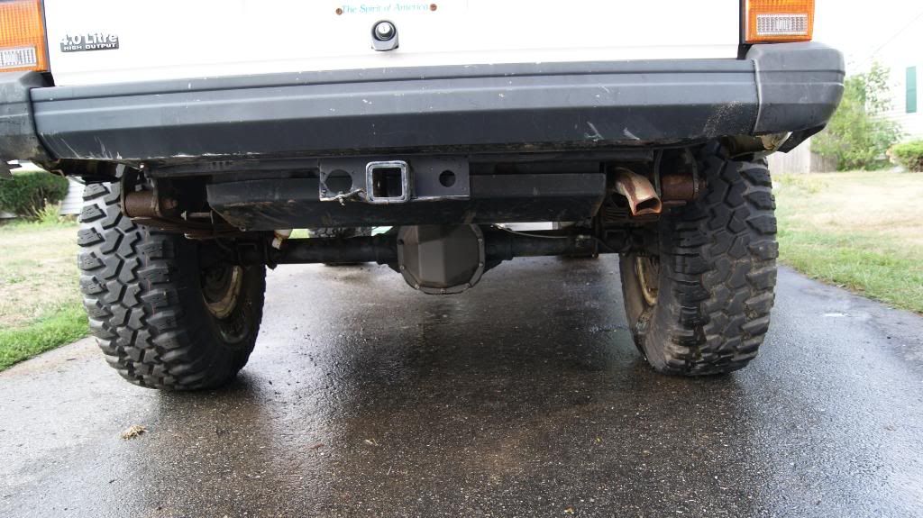

•   Ford Explorer 8.8” rear with mini spool, disc brakes, 4.88 gears and Ruff Stuff Axle brackets
•   Rubicon Express Hack and Tap slip yoke eliminator with CV drive shaft
FRONT SUSPENSION AND STEERING
•   Rubicon Express lower control arm relocation brackets with braces
•   Rock Krawler adjustable upper control arms
•   Crown Auto adjustable lower control arms
•   Rock Krawler X-Factor steering
•   Rock Krawler bomb proof adjustable track bar
•   Poly bump stop extensions
•   Rubicon express 5.5” coils with 1.75” spacers
•   SkyJacker Hydro shocks
REAR SUSPENSION
•   Rubicon Express 4.5” leafs
•   TeraFlex 1.75” Shackles
•   Stainless rear brake line
ARMOR AND RECOVERY
•   JCR Rock Sliders
•   C4x4 front tow hooks with frame ties
•   Skid Row gas tank Skid
•   Rear tow hitch (no trailer wiring, recovery only)
MISC:
•   APN header with new down pipe, cat and glass pack muffler
•   Bushwacker fender flares
•   Surco roof rack with light tabs and 4 roof lights
•   Hella 500 bumper lights
•   Bed lined lower half of vehicle
•   Added center console cup holders - 8/12/10

D-ring rear tow point for 2" receiver

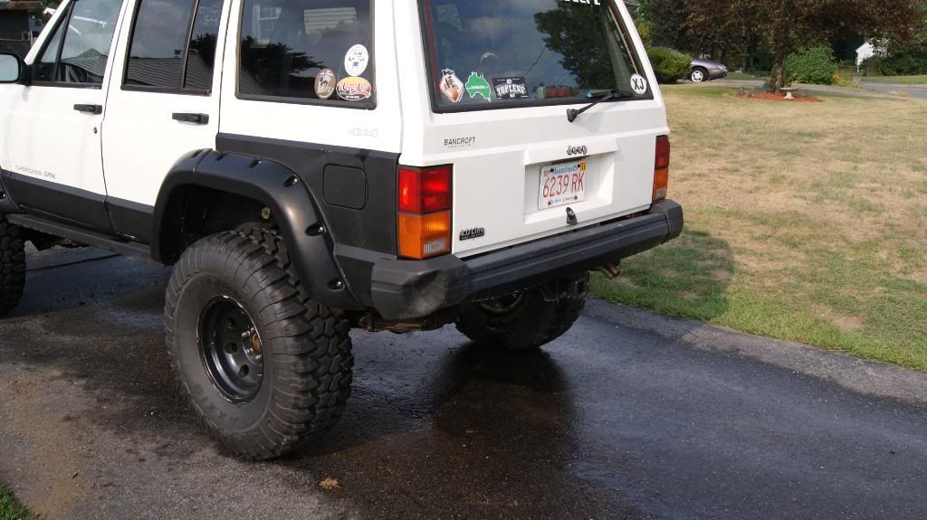

I also thought about the emissions thing, but I dont want a loud XJ, so the emissions should be a problem, if I could only figure out how to keep the tailpipe from rattling off the gas skid that would be premium (and no, I dont want to cut it off and have my child breathing all the fumes while Idling - recent horror story about that I would rather not experience first hand).
And about my avatar - I still own that dodge and can use it if I want to!  Kiss
I do think I want a new rear bumper with tire carrier though.... where is that jasonm guy at?? Grin
